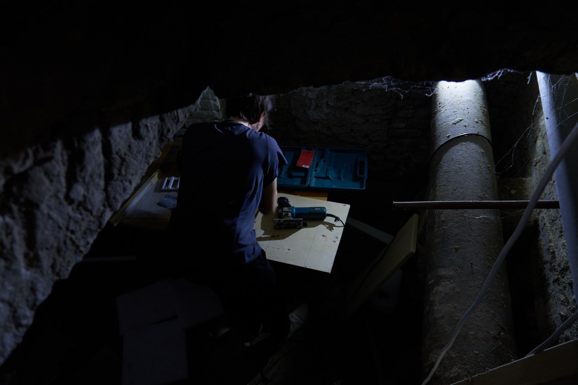

With this mindset, we shipped our first Grid modules in 2020 March. Those units were rough. Each one of the controller housing was milled by hand. The CNC mill was built into a desk we found in a garage.
We had to hide this "device" in the cellar, so we weren't disturbing the neighbours too much with the noise in the evenings. Anyways, it helped us get started with shipping our first working units.

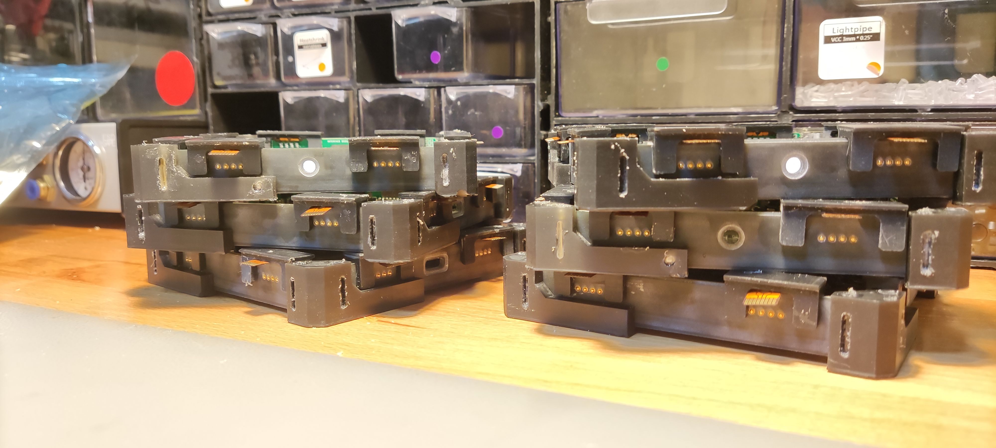

While the circuit boards were on their way to us, the quality of the module housing improved as well. We invested in higher quality resin 3D printers and built the best open hardware DIY CNC router we could find from parts across the web. We also built two large shelves as a manufacturing booth with an industrial fume extractor and protective plexiglass hood. Parts of the CNC router had to be switched around, but basically we used this setup of practices and machines to output 120 controllers per month. There were a lot of scrapped parts and it was a headache maintaining these devices. Despite all this, we still thought it was the right decision. These technologies helped us to continuously iterate based on the feedback we received from customers.
